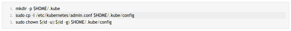

    3:后续使用过程中如遇以下问题:
    The connection to the server localhost:8080 was refused - did you specify the right host or port?
    执行如下指令

    第二步:根据提示输入三步法
    mkdir -p $HOME/.kube
    sudo cp -i /etc/kubernetes/admin.conf $HOME/.kube/config
    sudo chown $(id -u):$(id -g) $HOME/.kube/config
